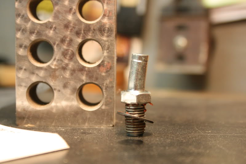

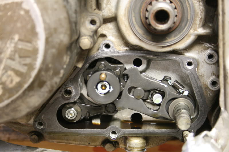

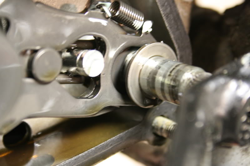

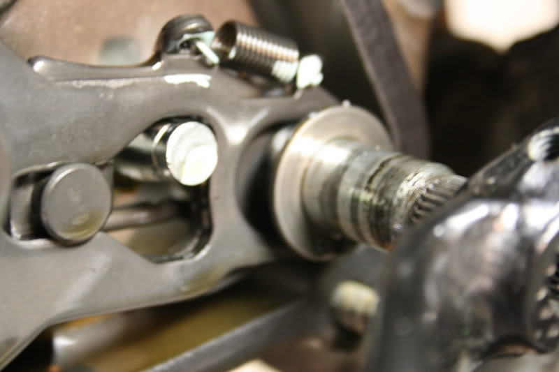

I'm not sure if this is the same "pin" you are talking about, but I bent the pin/bolt in my shifting mechanisim. It is in the center of the shift fork and limits the shift forks travel up and down. Repeated crashes jammed the shift lever, and thus shift fork, up, bending the bolt in the center upwards. Once this bolt was bent upward enough it wouldn't let the shift fork move down far enough to move across the neutral indentation on the shift star.
Cover off, bolt/pin is the silver thing in the middle of the shift fork.
Pushing shift lever down and Hitting bent bolt/pin before getting shift star all the way through the neutral area on the shift star.
Yup , it's bent.
Yup , it's bent.
Just put the new bolt in last night. Shifts like it should now. $6 part from bikebandit.
