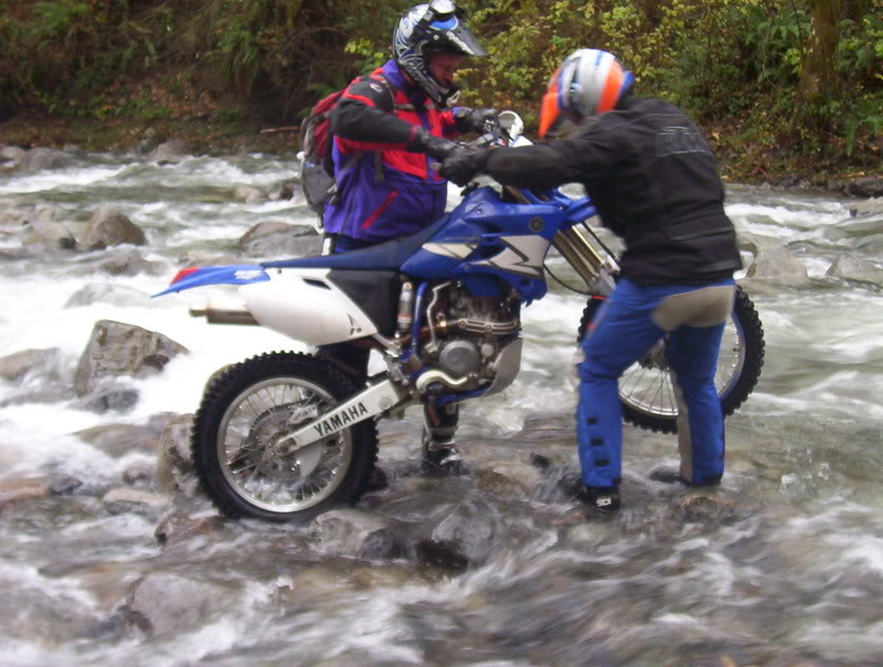

ORIGINAL: stellar_d
He deej, those greenish looking tubes you have running on either side of your airbox, is that the T-carb mod?
I installed that the day before I went to Reiter over by Monroe WA. Its a good thing I did, there were water holes over 2 ft deep. I think the bike started to float at one point.[8D]This guy didn't have them and 1 mile into the ride he was dead in the water. Plugged the main jet and had to idle back to the staging area.
