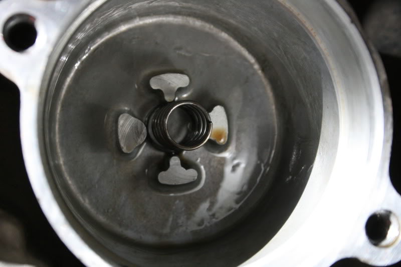

It doesn't look like anybody has mentioned bending the spring bigger on one end yet
You might as well fix that little problem, rather than putting a band-aid on it.
Congrats on the bike!
Dan
