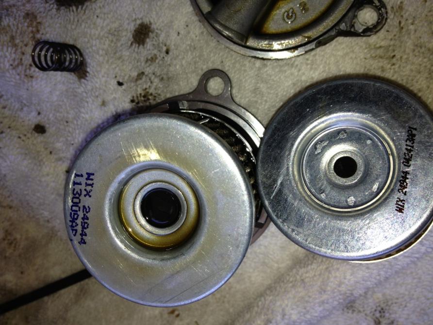

Has anyone else had this happen? This is twice now that the oil filter doesn't seem to be the same. The model number is the exact same, its been 4 months since I changed my oil. Why can't changing the oil be simple. I have a hell of a hard time finding the correct filter! Rage!

For what it's worth I use the K&N filter part no. KN-112. I think the Kawasaki part no. is 52010-1053.

i have changed my oil 3 times now and yes your right ever time i get the filter home it is different size one of them was 1 1/4 in dia. 32mm for you metric people out there

You should let wix know. They might make it worth your while.

What filter? I'm taking advice and trying the K&N filter. As well as complaining to wix...I have photo evidence...EVIDENCE!

Wally-world and Advance Auto carry the Fram that fits the KLX. I forget the part number... I can get it for you if you really want it.
Personally, I would not use a mesh or K&N type in my bike for the simple reason that it's a filter, and I want it catching the smallest particles possible. Mesh filters can't do that as well as a paper filter.

The fram is a CH-6015, and they too had the small little hole instead of the larger hole. Do you guys use the filter with the smaller hole?
