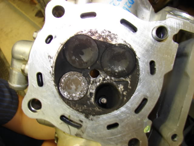

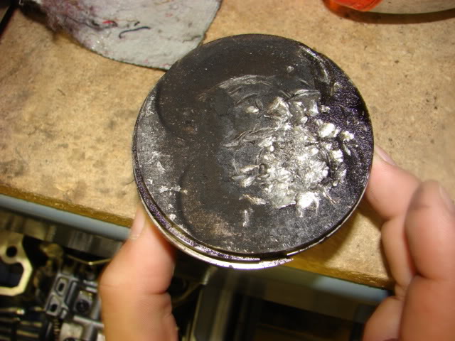

The only time my KLX used oil was when the piston was hitting the intake valves...then this happened.
This was after a moronic "mechanic" (use that term loosely) put a new head on it and didnt check the piston-valve clearance.
