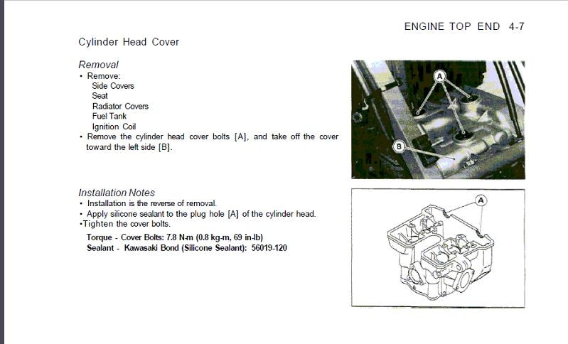

Found the appropriate page in the workshop manual, so should I apply the permatex sealant to only the areas indicated in the below picture, or all around?

The half moon's will stop the leak but I apply it to the entire perimeter-I figure that it's easier to do it while I have the cover off. Only downside is that you will need to use care when removing the v/c for your next service-you may need to use a blade to break the bond of the sealant, it can be pretty tenacious.

Thanks, I may just apply it to the half moon, as the rest seems pretty tight and see how it goes.
