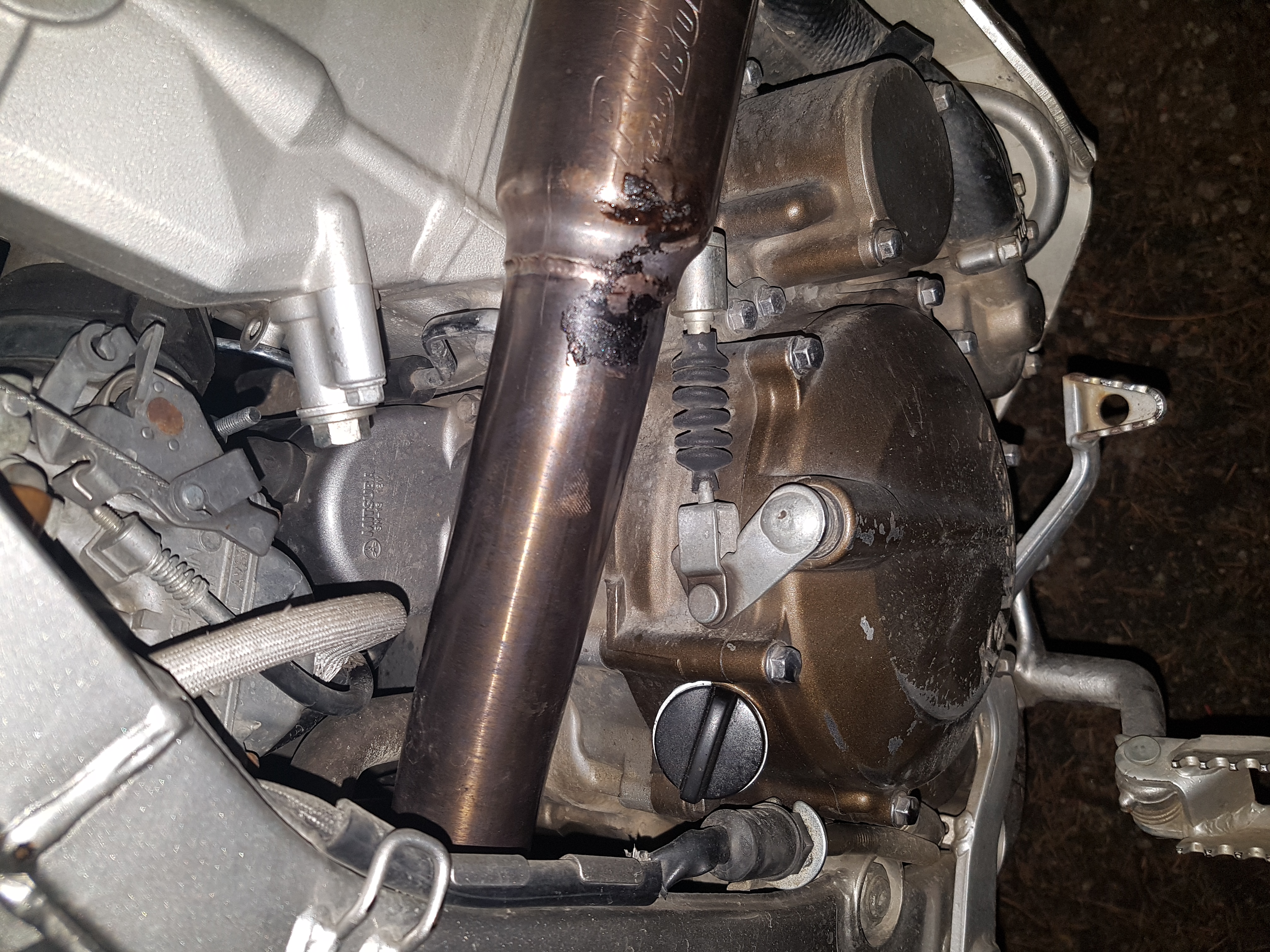

I've included a pic of the clutch arm on the right hand side of the bike, incase it looks out of wack. I thought they were supposed to be at more of a 90' orientation to the crankcase. Don't tease me about my rainpants melting on my header pipe :/

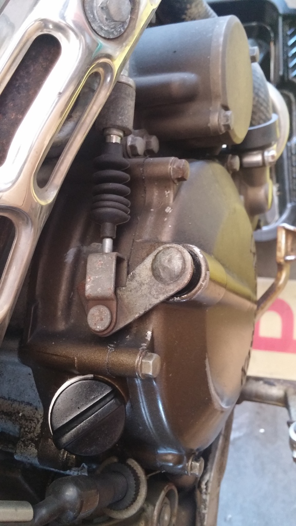

Don't know about the rotella I know nothing about it. Start off with the simple things, clutch adjustment cable adjustment, lever moving free and lubricated, gear lever not bent or damaged, gear shaft not bent. How long since you changed the oil.
Oh and you need a heat guard on the pipe

Clutch arm looks normal. If its hard to get into neutral especially thats almost always your clutch not disengaging all the way.
