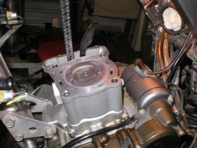

Yeah, if it's really not a ticking or metallic sound, it doesn't sound like the cam chain. On that rubbing slider you're referring to, if I recall, one of them does seem to just sit in a slot. I don't remember a bolt-and-tab setup that retained any of the sliders, but it's been a while. I'm thinking the slider you're referring may indeed just sit in a slot, and when the cam chain is tensioned with the cams and tensioner in place, it can't go anywhere. Maybe some who've been into their engine more recently can shed more light on it.

Here's a pic of mine with the head off and the 300 cylinder on. The rear slider is fastened down in the case on a pivot, but this shot kind of reminds me that the front slider you're referring to didn't bolt to anything and wasn't retained by either the head or the cylinder. I just seem to recall that you fished it down into the engine case, and it rested in a slot in front of the chain. Heck...I'm even too lazy to go out to the shop and dig out the factory manual.
