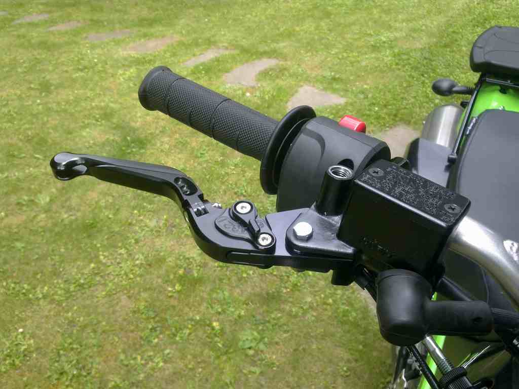

Originally Posted by durielk
Your full of shiet, where do I send the bill?
No way those will fit a 250klx.
You better send some money
Here are mine
Attached Thumbnails Ninja 250 Lever compatibility?-001-.jpg   Ninja 250 Lever compatibility?-002-.jpg

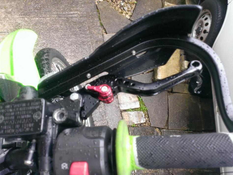

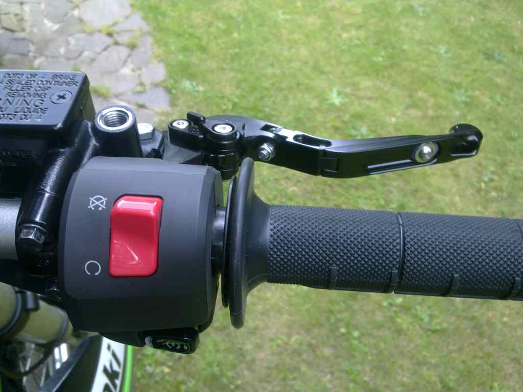

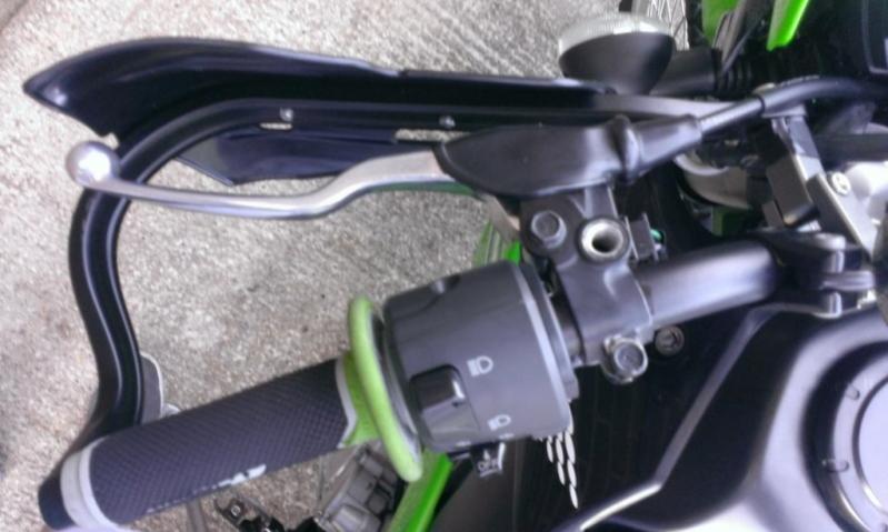

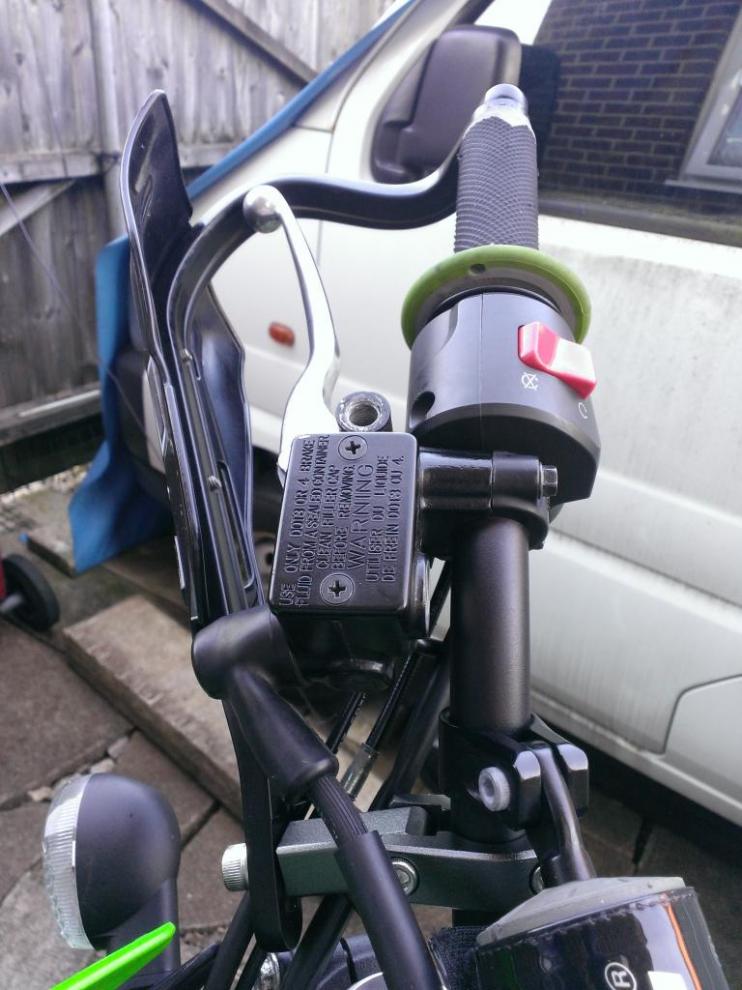

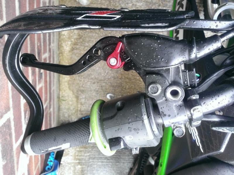

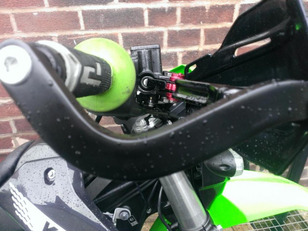

A few weeks ago i installed a set of Zeta XC hand guards.
After installing the hand guards, cables started to rub and wear against the bracket of the handguards, even after trying to reposition all the levers and controls the best i could.
The OEM levers were also far too long to fit behind the guards to prevent them from breaking/snapping in a drop.
After reading that ninja 250 levers are compatable with our KLX's
I decided to take a gamble and order some of these levers.
Short Brake Clutch Levers Kawasaki NINJA 300R 2013 NINJA 250R 2008-2012 Black | eBay
These swapped over with the OEM levers almost effortlessly.
There is now plenty of space between the each lever and the handguard also resolving the issue i had with the rubbing of cables.
Although i did have one concern.
My clutch cable seems seriously tight from the lever, around the frame, all the way to the clutch, is this normal?.
How have you guys got your clutch cable positioned?
Thanks
