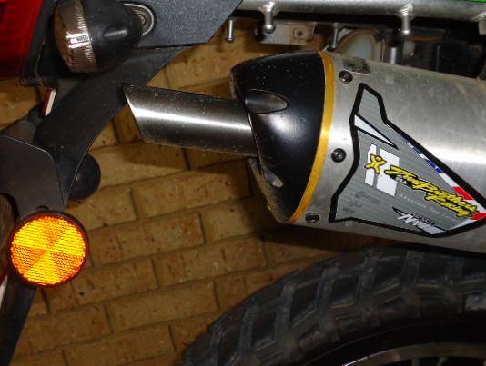

Originally Posted by Ozawindib
Two Brother says their P1X Power Tip would reduce the sound to acceptable levels. BS
If any of you have experience with one of these, would you kindly let me know if you thought the noise reduction was significant? No
I made my own tip. At least I can hear the engine now. I rode around my house the other day without my helmet; still quite loud so I repacked it. I believe FMF are the way to go especially if you do a lot of commuting in suburbia.
Attached Thumbnails Newbie Question--removing exhaust/muffler-dsc04120.jpg   Newbie Question--removing exhaust/muffler-dsc04124.jpg
