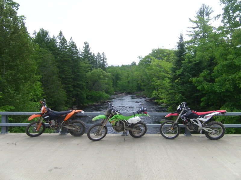

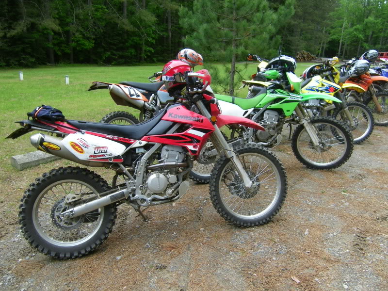

Wasn't Wabeno fun??? I almost put it up on the board here, but never got around to it. Too bad, I would have liked to say high at least. I saw quite a few KLX's there, one of them must have been yours. I will catch you next time if you plan on going to the big woods ride in the fall. My buds and I will be there for sure.

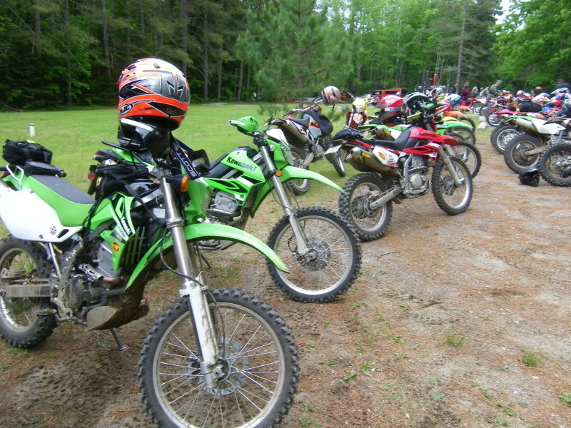

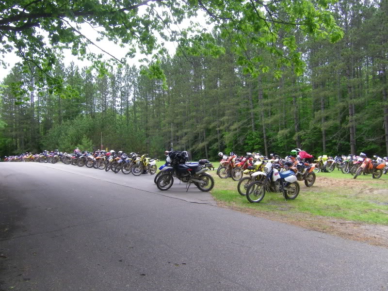

yours?
