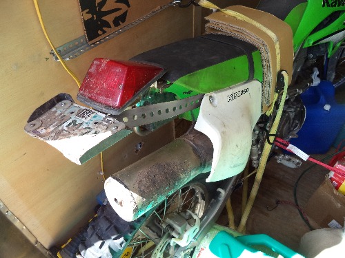

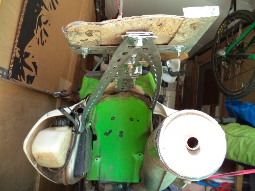

So till my new rack comes & I get back to AZ to put it on here it is.... I'm thinking some of you need this.

So...what the heck were you carrying back there?...your secret stash of gold bullion?

aaaahhhh! A gallon of gas & my emergency tools for tire change, maybe 18 lbs or so.... Oh yea, I bottomed the rear end a couple of times, but they weren't big hits. I made it back to the motel with a little help of my friends. It didn't break where I fixed it, it broke another 6" towards the front.

I rode some ST out of Aspen today, my new subframe did not fall off! I put my tools in a bag bungied to the back of the seat (i never ride there anyway unless I am wooping it up).
