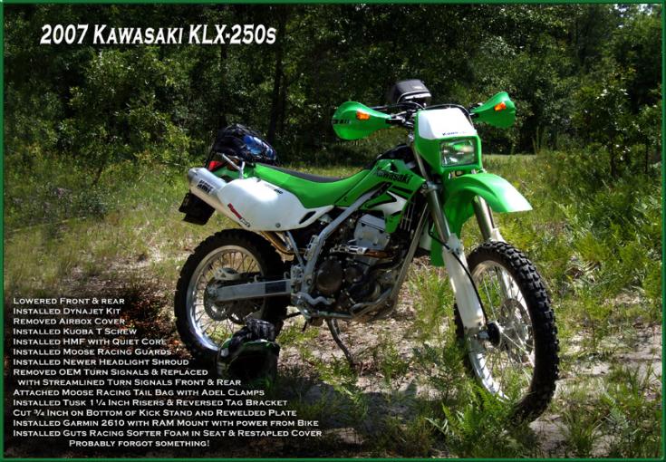

Sid - Already done all of the carb/air box/adding HMF pipe and those all just added more guts fo the bike. If I can get the pic to post, there is a list of mods on the pic.
Attached Thumbnails New Rear Sprocket Adventure-klx250_with_info_smaller.jpg
