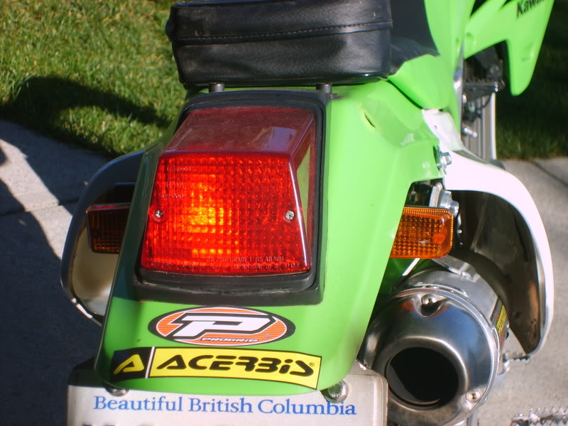

This is the MX style rear fender for the KLX300R from Maier Manufacturing: http://www.maier-mfg.com/
You can get black, white, or green. I just got green because I didn't want to have to buy matching parts in another color for everything else. Plus, I wasn't yet sure that it would work. But this one bolts right on but has no facilities for the light, blinkers, etc, so you need to work something out like I did. My layout seems to work OK for now, but I consider it a first pass and will clean it up more over time.

Nice Looking light/fender config Brian, very 300ish looking.... should go well with the big bore!! Question for you... What kind of tire is that on the back? D606???
That's a Kenda K760, aka Trak Master II.

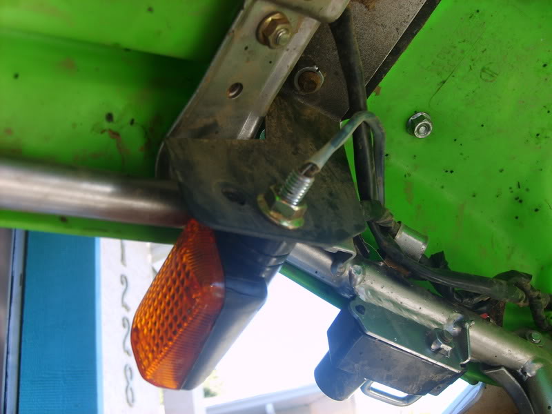

The fender looks great much better than stock but if the bike ever gets dropped i think the turn signals will take the full impact.
I put my lights in tight for protection this might work with your new one.

Hey, nice bracket - I like that.
