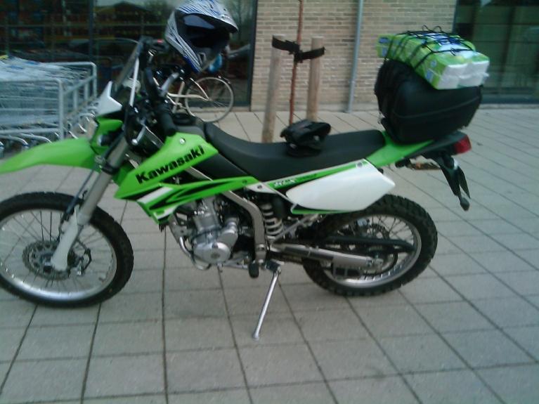

Can't stand riding with a back-pack, so I needed to mount a top-box.
That takes a rack - or does it ? After some speculation and picking the rear of the bike apart I could see that all it takes is drilling 2 holes in the rear fender to make 4 anchor-points for mounting the base-plate on risers (made from alloy tubing) and some stainless bolts nuts. Got pics of that project, too.

And a picture of my bike - with luggage ;o)

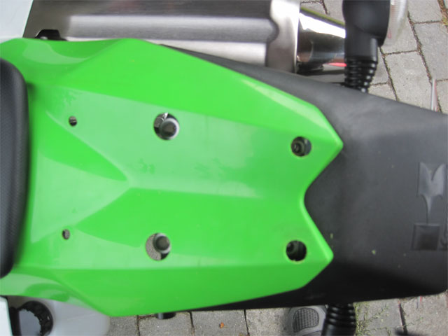

And I've utilized 2 crossmembers as anchor points for it; the front one that the original toolpouch is bolted to and the one behind it, where the rear fender is bolted to from underneath.

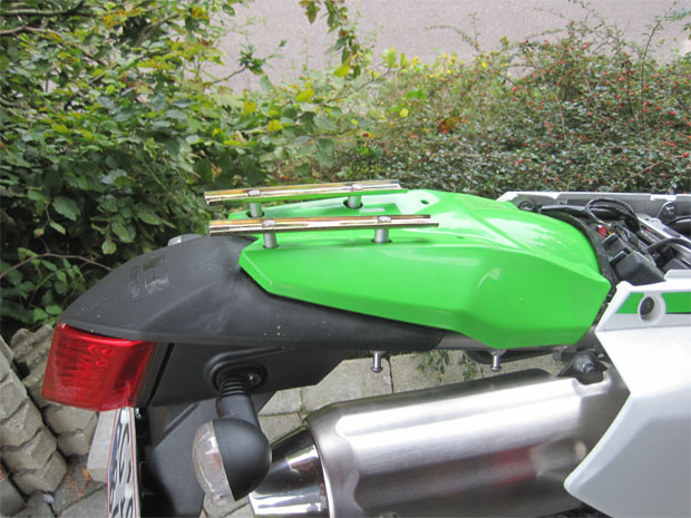

This "only" took a deep breath as I had to drill 2 large holes in the rear fender in order to bolt the 2 bars in the picture to. The holes are drilled from beneath through the 2 bolts that are mounted on the black part of the rear fender. I then bolted the rear of the bars from the upper side, thus first bolting the bars to the rear fender, mounting the fender and theese 2 bolts go down through the rear crossmember and and secure them with nuts from the underside. Front holes you just put the bolts through from the top at secure them with nuts on the underside.
May sound confusing - but pick the rear of your bike apart and its pretty straight forward - once you get the idea ;o)
The box is mostly used for the little things, you can't doo without; lock, tool-kit, rain gear and a little shopping - and almost only on paved roads.
Should I do extended gravel etc I would really consider leaving the box at home to avoid overloading the rear sub-frame ;o)
First pic is from above: 4 large holes mark the mounting points on the crossmembers:
Second pic is the bars readily mounted - base plate to be screwed on top:
