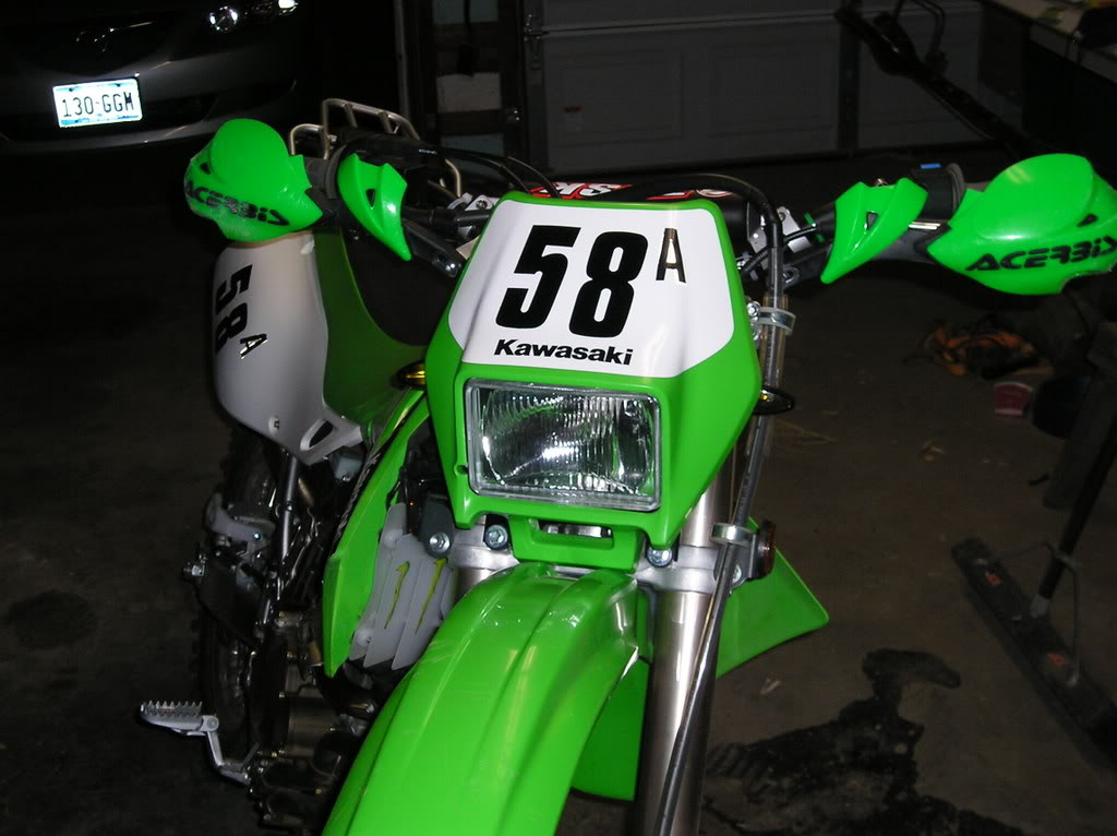

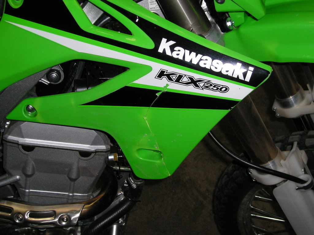

Yup got my Q4 on i'm stoked, also got my row assignment... man this gonna be one hell of a sunday.. i'll bring a post race pic and review sunday or monday!!!! Garage is dirty.... oh and my broken right side shroud!!!

Fmf looks good. Good luck on the race this weekend.

Nice! [sm=smiley20.gif]
I'm looking forward to your race report.

looks good. you ought to like it. what are you running for jetting? i have a pumper and am running a 132 main with a LARGE hole in the airbox lid. with the vortex throttle i really like the power off the bottom. i'll be curious to hear how it all works out for you on sunday. good luck

Ack.. ya no jetting yet, airbox still same however i did notice power increase!!!! specially in mid range, but, but , my fair weather friends, the klx 300 dyno jet kit is just around the corner!!!!! Its next on the list , it will be my birthday present next month....if i dont screw it all up with my install!!!!

To fix the shroud CHEAP!!!! drill a bunch of holes and zip it back tight together with zip ties.....
I use a "third hand" brake tool from a bicycle shop to pull my zip ties rediculously tight...I have fixed many plastics this way on my atv....expecially floorboards that tend to get branches "punched" through them.Till I can get new plastic ...or the cash to do that as well.....zip ties are cheap.
