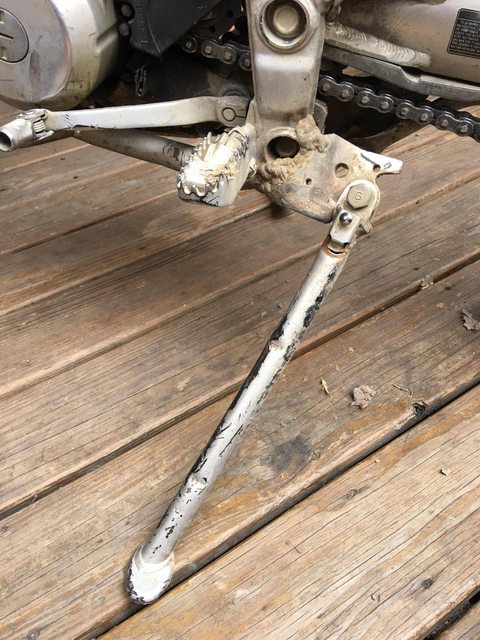

After kicking around the idea for a few years I pulled the trigger on a dual sport with weekend- a 2009 klx250s with 3300 miles. The bike is in good overall shape, fresh tires and Fmf exhaust. The only major issue a bent kickstand. It was (poorly) welded once by the previous owner, but is beginning to sag again. I've attached a picture, and would appreciate your input on possible fixes. Should I have this ground off and replaced with a stock assembly? Aftermarket options?

Yeah, that looks pretty sketch. Grind off and replace sounds like a plan.

I hope you didn't pay too much for your KLX. With only 3300 miles the kickstand certainly has seen some abuse. Kind of makes you wonder about the rest of the bike.
Those gobby welds certainly aren't done by a professional. I'd definitely have a pro re-weld that plate onto the frame. Looks like you couldn't get a socket on the bell-crank pivot bolt now either. As far as replacing with a stock part, that could be a problem. I think the plate is considered part of the frame and would not be available as a stock part.
Besides the two dents in the kickstand there also appears to be an open crack near the top that also needs to be welded. (might be an optical illusion)

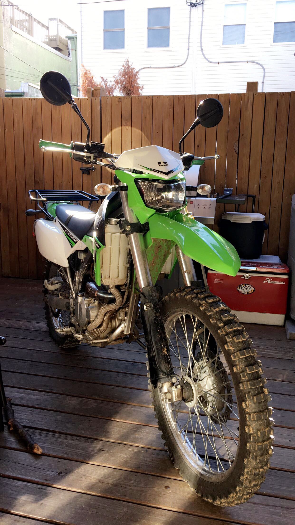

I think I got a pretty good deal. $2300 in rural PA, and kickstand is the only option. The bike has seen some woods action (obviously) but seems to be in good mechanical shape.

Considering the now confirmed overall good condition of the bike, I would try to retain the stock configuration. The plate mounted to the frame seems to be functioning even if it has been cobbled on. A good welder should be able to make it look almost new. If you're concerned about the kickstand leg itself, those are available used. Typically, they go for about $60 on eBay. If you do buy one, make sure it is for the KLX250S model, not the KLX250SF. The SF is a moto version bike with smaller wheels and a shorter kickstand.
