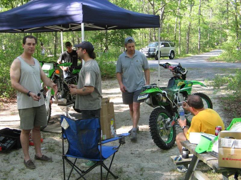

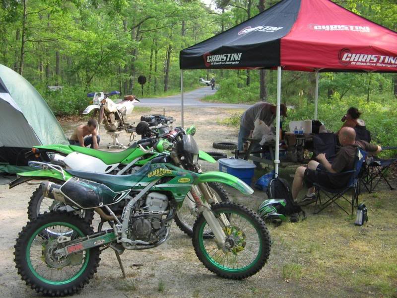

Default RE: New Maier MX rear fender...
i got your back... doesnt look too bad
Sheeeeit, I was standing next to the bike and scoping it out for I don't know how long that weekend and I didn't even pay attention to the rack[sm=bustedsign.gif]
