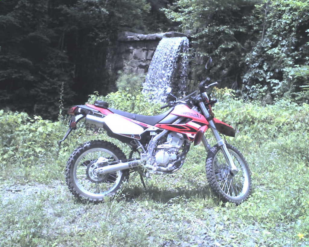

I love my KLX, on the road she gets you from point A to point B, in the trails she rocks!
Wait until you open her up with full exhaust, jet kit, and snorkel delete. Saaaweeet!!
