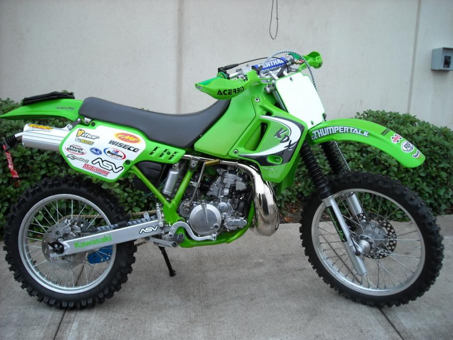

As far as the new plastics, the current owner said one of the side panels has a scratch on it, not that it matters, but half the fun is turning this into a "Project"! A few years ago I built a 89-92 KDX from the ground up, one Ebay piece at a time and had a blast doing it although it cost me more than I could buy a new bike for.
