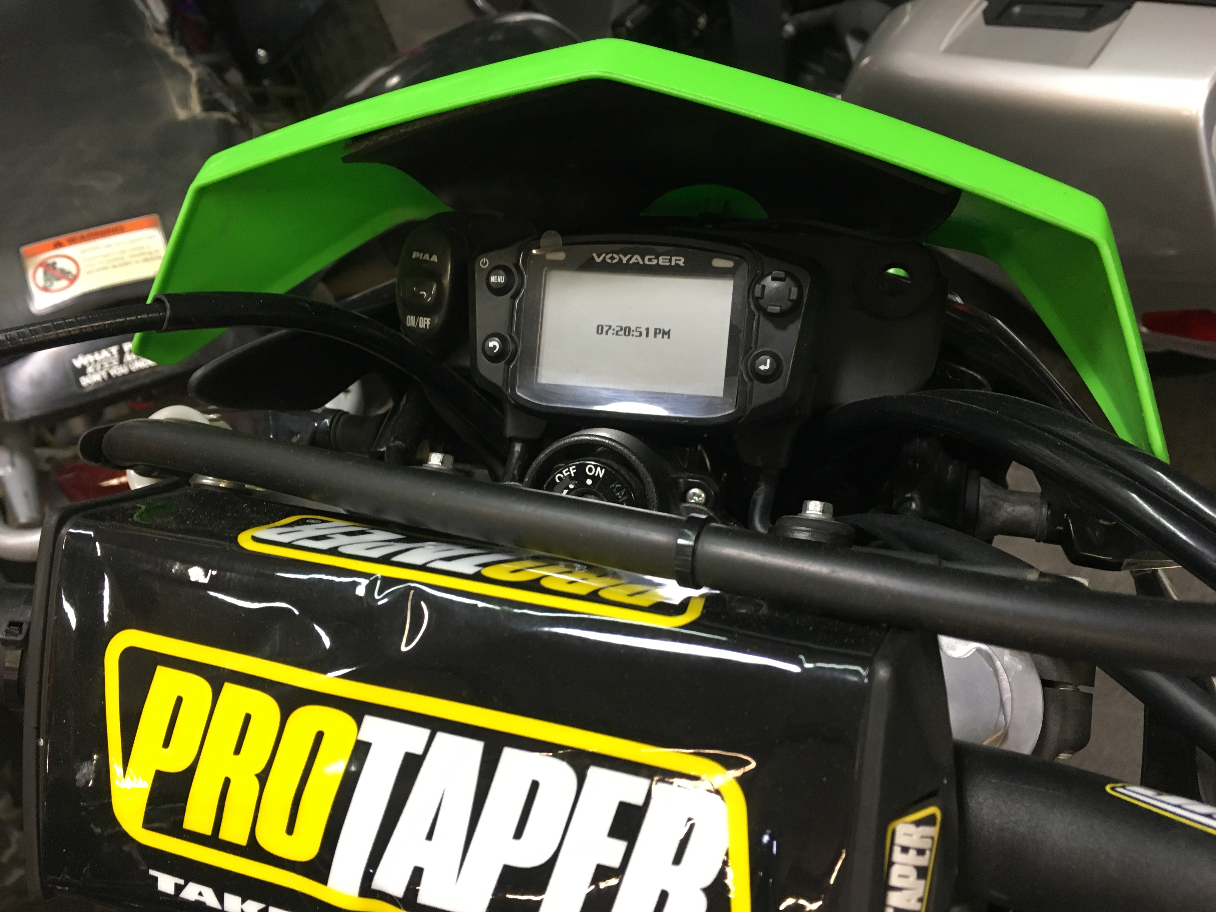

1 - Previous owner replaced the dash with a TrailTech Voyager. In so doing the turn signal indicator went away (and experience has shown I need one). I have an led indicator light to install but I'm not sure where to wire it to. The original dash has an indicator so I know there's a point I should pull from.

7 - My tach on the trail-tech stopped working during my last ride. All the connections seem sound and the wire wrap around the spark plug cable seems secure. Is there something else I should be looking at between the spark plug and the display or could there be something altogether different causing trouble?

1 - I use a trail tech vapor and got the dash unit with neutral, signal, overheat and high-beam indicator lamps. Can you find the original wires for these lamps and tap into one for the signal indicator?
7 - I don't know why it quit working. That's strange. There is a better way on the KLX to do this though as there is a wire that fed rpm to the stock cluster and this wire should be used for the trail-tech unit. I think mine was brown?

I spoke with Trailtech to inquire about the capabilities of the Voyager. Unfortunately it doesn't have signal, neutral, or high-beam indicator. Apparently the Voyager was intended primarily for off-road use. Knowing all of those wires are available I'll just need to track them down.
Thank!
