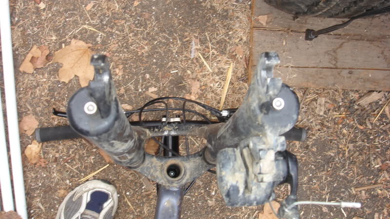

hey Dirt are those "dirt plugs" any thing like these bolts at the bottom of my forks(this is a pic of my GT MTB forks)and yes if you were going to ask that is a disk brake caliper

Not exactly. The "dirt plugs" I was referring to on our KLX 250s are actually little rubber plugs that are internally inserted into the access hole where the adjustment screws are at the bottom of the forks. I called them "dirt plugs" since they plug up the access hole and keep the dirt and muck out.
You need to pop them off first, then adjust the screws. I would guess (don't know for sure sinceI never owned a GT MTB) that looks like its probably the same mechanical principal.
