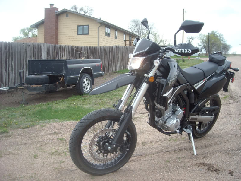

I have a pipe cutter, thinking now just to get a set and adapt however I need to. I'm no Enduro racer, but will be seeing all kinds of trees.
Those Acerbis look good, do they come in KLX Red?

Not sure about Acerbis but Barkbusters come in KLX Red
My Moose ones came in KLX green red, black, white, etc...
