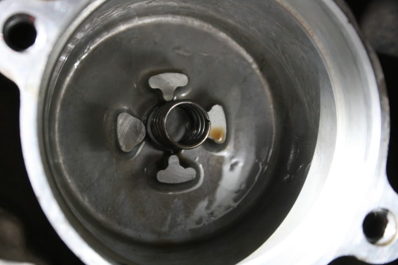

Next time you do an oil change, bend the end of the spring open a touch (make the diameter larger), put that end in the bike and it will stay there without falling out. No more monkey business or grease. Kawi should have put in a larger spring in the first place. ??????
It is very satisfying to do your own work, and you probably do a better job, even if it is your first time.
Dan
You can see I made the bottom loop bigger.
