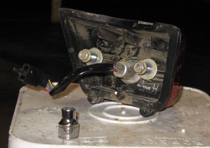

A big reason I decided to keep the stock plastic is that without it, the taillight is exposed. There is no back on the taillight, so it would just be dangling in the wind, getting pummeled by mud and rocks, and plus, the turn signals would also be kinda isolated. Basically, without using that stock piece, everything isn't brought together.

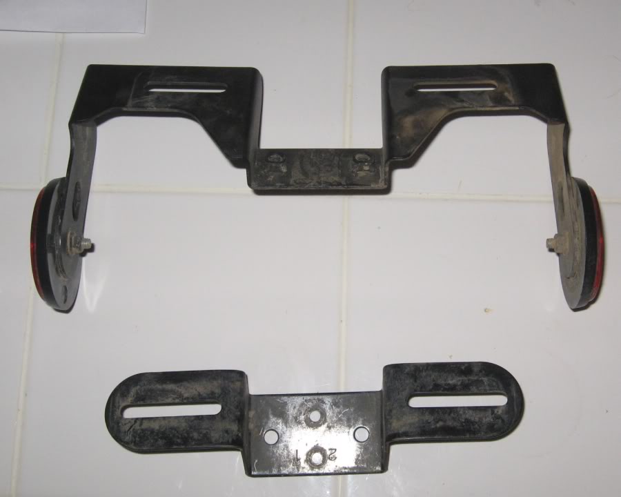

Comparison between the heavy, ugly stock KLX bracket on top, and the bracket from my dad's DRZ-400, which is significantly lighter.

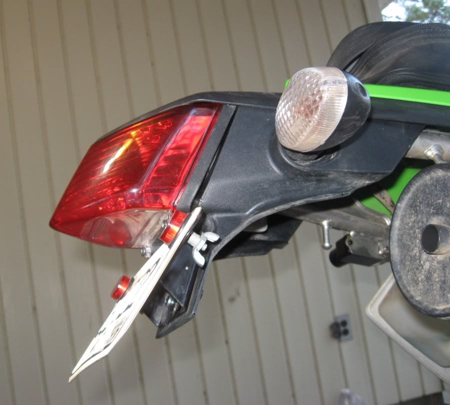

We trimmed the fender pretty high up. If you look at yours (the pics aren't great) you can see the plastic is pretty stout right in the curve, you can see that it is rather thick and sturdy, so we feel confident it will hold up. We cut out a piece of alluminum to bolt the plate bracket to, and we used locking nuts. For the signals, we used pieces of alluminum to mount the signals and connected them to the tailight bolts via L-brackets. The whole assembly feels much sturdier and solid than stock. The taillight doesn't just flop around anymore, either.

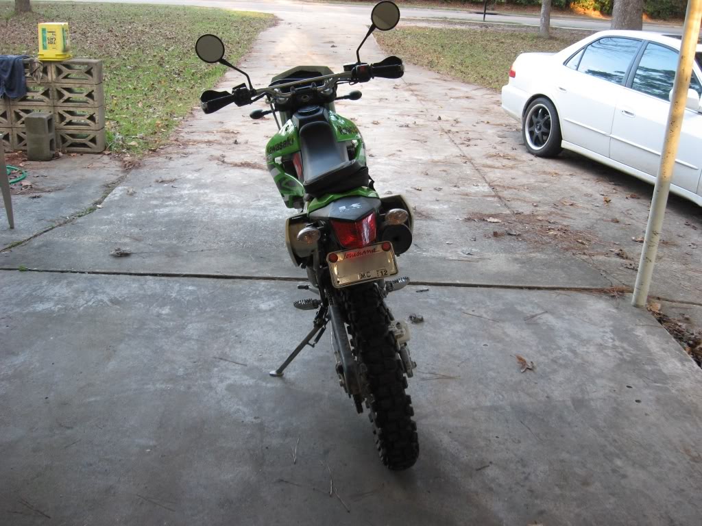

And here's the end result.
The taillight lights the plate much better, I think the bike looks 1000 times better now.
