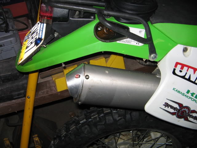

lol.. mine is the unnamed rattlingwonder now....

ok here is a pic of the big gun end pieces
OK now the end cap thats silver, not the red edcap, is what i think i may have scewed the threads up on... Stock the screw holes dont go all the way through the piece of alum..... now to fix this the way i think im going to have to is drill those holes completely through thate piece of aluminum, but there will always be screws in that hole, to hold the end cap on. Can anyone see something bad happening from drilling those holes straight through? Its not going to push the screws out or anything will it? Any ideas, or anything?

I would think you could just drill that out and tap it at the next larger size and just use a slightly larger screw. Then invest in some lock-tite.
