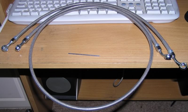

To improve front brakes esp with road tyres on and hopefully fix the lack of feel of the back brake. Anyone know what the little rod is for? I have no idea.

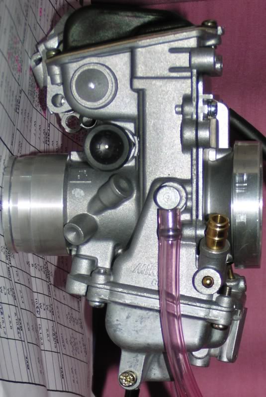

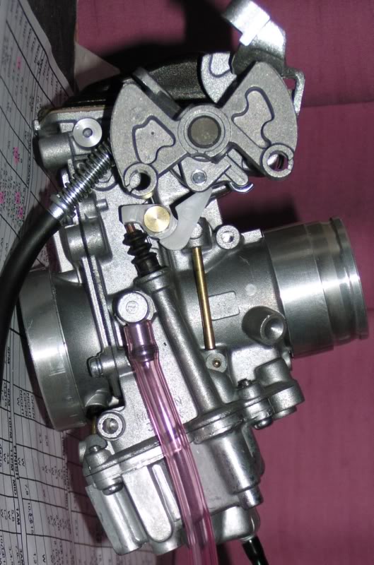

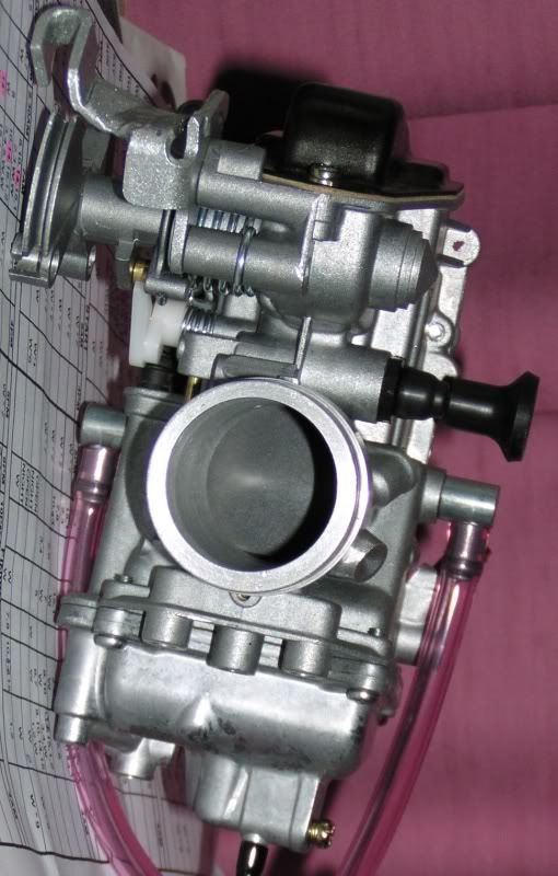

We all know why this little baby was ordered, to give the KLX a little more instant acceleration, to help with getting the front over trees etc. Also it is about 1/2 the price of getting the stock Mikuni TM33 in Australia. Nice work Bill.

The rod that was included with your carb is the stock accelerator pump rod. Bill installed a shorter A/C pump rod in your carb already. The reason for the shorter A/C pump rod is that it engages the accelerator pump throughout the entire range of throttle positions, giving better throttle response. The longer (stock) rod will engage the the accelerator pump only until half-throttle. After that, just the slide position is changed. On a TM33 carb, the big hit of fuel that is given with the stock A/C pump rod will sometimescause a bog - the opposite of what you want.
Old Jun 20, 2007 | 12:56 PM
mustang's Avatar
Posts: 463
From: Kersey, PA
Default RE: MY new farkles thanks Bill
I forgot to tell you congratulations on your new bling! Let us know how the new brake lines work.
Did Bill jet the carb for you, or are you going to do it yourself. A good starting point is to run a 40 pilot jet, 140 main jet, and put the clip on the needle in the2nd slot from the top. The stock needle jet (the brass tube that the needle slides into) is a P-8. I went one step richer to a Q-0, and that really improved the mid-range.
