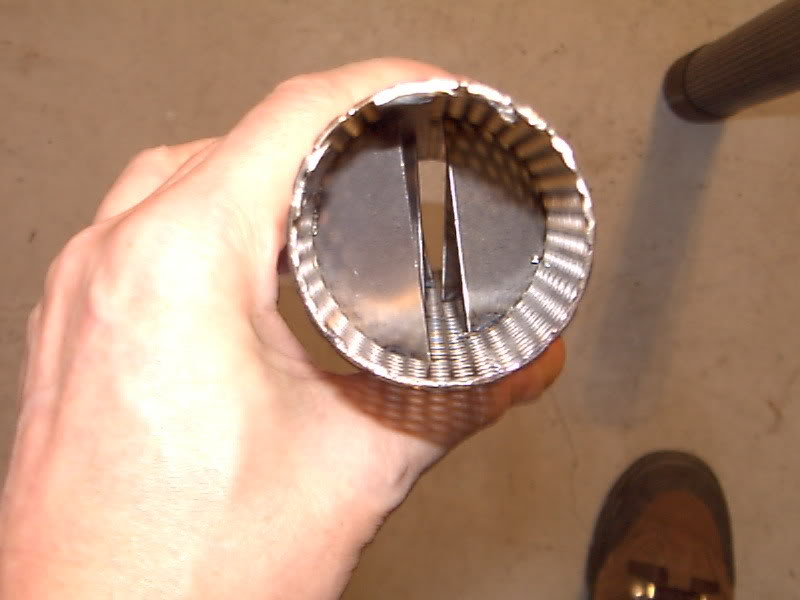

Here's a couple more photos:
Quiet Core and Race Core side by side - you can sort of see the 5 Quiet Core baffles :

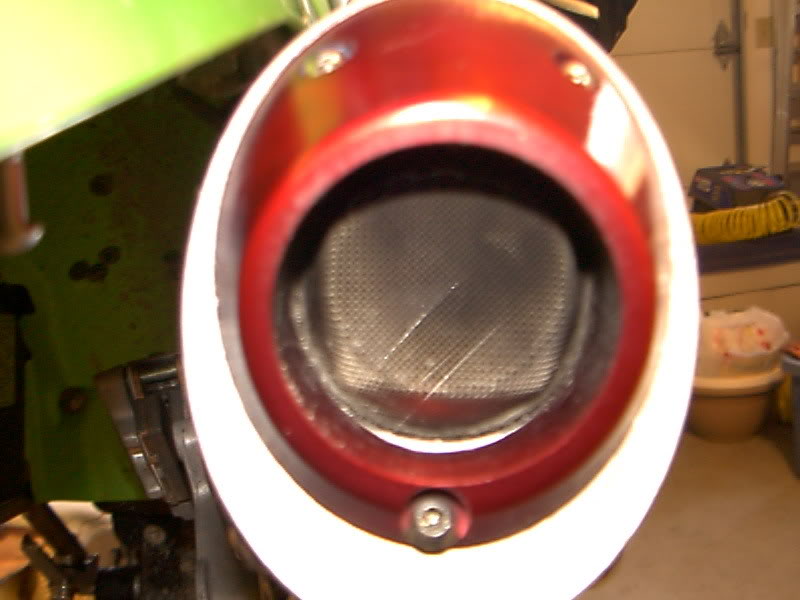

Final assembly with spark arrestor in place (angled orientation of the baffles was intentional - tried to get exhaust flow away from the rear fender, but I don't think it made a difference):
