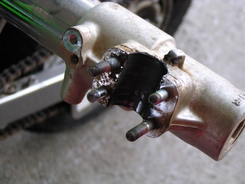

You guys are heavy handed, don't worry so am I, I broke 2 of the studs holding the front axle in place.[:'(]

I now have a torque wrench (or 2) and use it.

hahah I got a couple torques too. One for my rear axel and counter sprocket nut, and one for my oil drain plug...which i forgot to tighten once...woops
btw what do you torque those 4 nuts to

9.8 N-m or 87 in-lb .... thats INCH-pounds not foot-pounds

Damn, if it's that easy to break the studs just bolting the cover plate back on, what's to stop you snapping them when you hit a rock head on?

On the front axle studs, replace those with bolts..... thats what i did... one of mine snapped when i bought the bike. I have also had issues with the Big Gun end cap. and had to buy a new one cost me 70$.......
