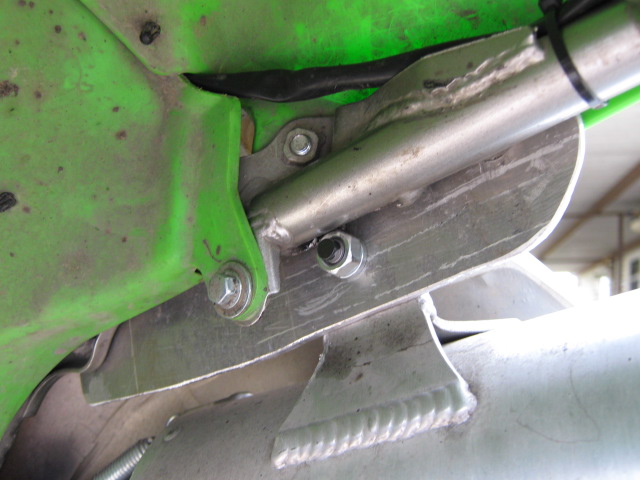

Hi. I ran a full Muzzy with DJ's stage 2 rec's, 128 main and 3rd notch. Airbox lid removed and aftermarket air filter. These settings worked perfectly for me. When I switched to a 330 the only change required was 132 main to give enough gas over 7K. Only potential change would be to raise the needle one notch - but it would be to experiment, not because of poor performance.
I like the Muzzy - looks and sounds great - the only caveat is the cannister mount point on the bike is too weak. The original attachment point let go fairly quickly, a re-weld lasted only a month or so, and the final fix was a 3 inch plate welded to the bike's rail with the nut welded to the back of the plate. The Muzzy only uses one of the frame's two cannister mounting points and I think the springs put additional stress on the single connection. Also the cannister has a tendency to vibrate lose so be sure to use a lock washer and blue locktite.

Agree on the weak muffler subframe bracket. Instead of welding, I cut off the old, broken subframe tab and made a heavy duty aluminum bracket that spans across 2 of the bigger bolts that are on the subframe. The aluminum bracket is made out of 1/8th thick aluminum, so it's easy to cut, shape, and drill. It's been on there since 2009 without any issue of cracking or failing.
Attached Thumbnails Muzzy full exhaust, more jet changes?-muffler-bracket.jpg
