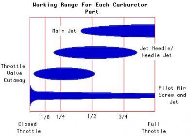

http://www.mikuni.com/pdf/hs40_manual.pdf
Richard, whose chart is that? The chart for the 40mm pumper shows a similar graph, but in two separate locations in the actual text, the description for the needle jet is 1/16th to 1/4. I think I'd go with the text.
I see the graph in the HS40 manual now and it's also showing quite a range for the needle and needle jet. Since we know the two work together to meter fuel at throttle openings needing more fuel than the pilot system and less fuel than the main jet in these variable venturi carbs, it's safe to assume the graphs rather than the text are correct.
Actually I don't think the jetting graphs for the HS40 would be much different than any other Mikuni or even any other modern non-CV m/c carb since they all have the same parts?
