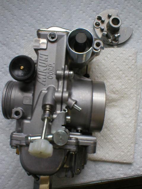

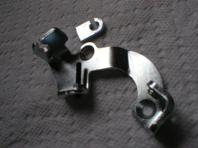

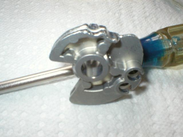

so my question is how does the TM33-68 fit under an IMS tank ???
i know the tank is very close to being stock
Old May 29, 2013 | 04:33 PM
TNC's Avatar
Posts: 5,050
From: Abilene, TX
If I can get the carb to fit under the supertanker Acerbis tank, there surely can't be too much work to get it fit under anything else. Here's a couple of pics for the Acerbis application. I basically just removed all the return cable bits off the throttle cable holder and the throttle wheel with a Dremel tool and bench grinder. It sounds like a big deal, but it was a piece of cake. Those two components unbolt off the main carb body easily so that you can easily cut and grind on them.
