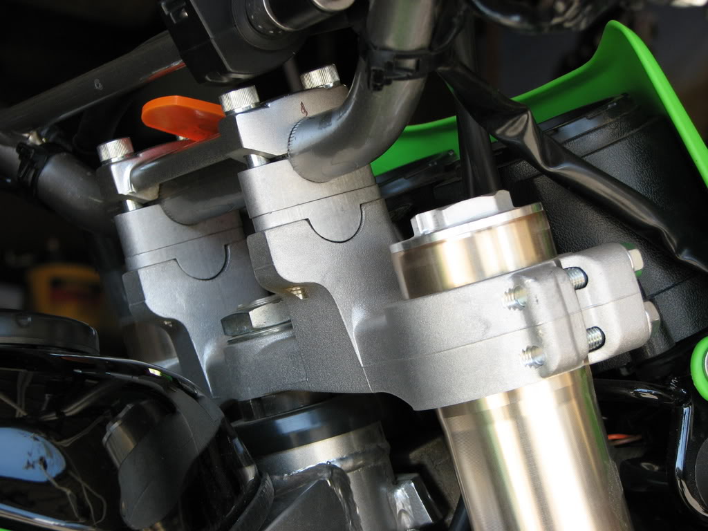

Here is a photo of my front forks in the clamp (note bar risers)

Maybe I'm crazy, but the way I see it I can only slide the forks up 1/2†and then I'm into the tapered part... The first two pictures show how it came from Kawasaki – with 1/4†of fork tube showing above the clamp. 1/4†stock + 1/2†additional = 3/4†total. The last picture shows a bike that has some sort of shim around the 2mm smaller section of the fork with well over 3/4†of fork showing. I bought the eBay links and they don’t come in a 3/4†length so I guess I’m screwed. You have to raise/lower the bike the same amount front and rear. I know some people just say to hell with proper rake/trail, but that’s flirtin' with disaster.
