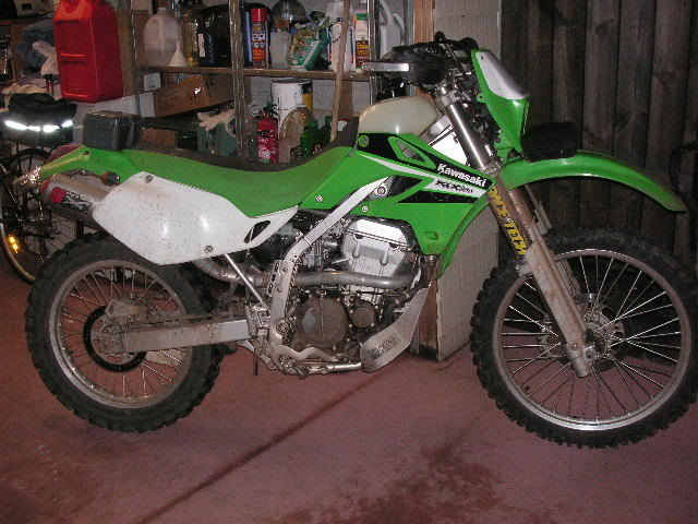

Neil do you have any other pics of that skid plate?

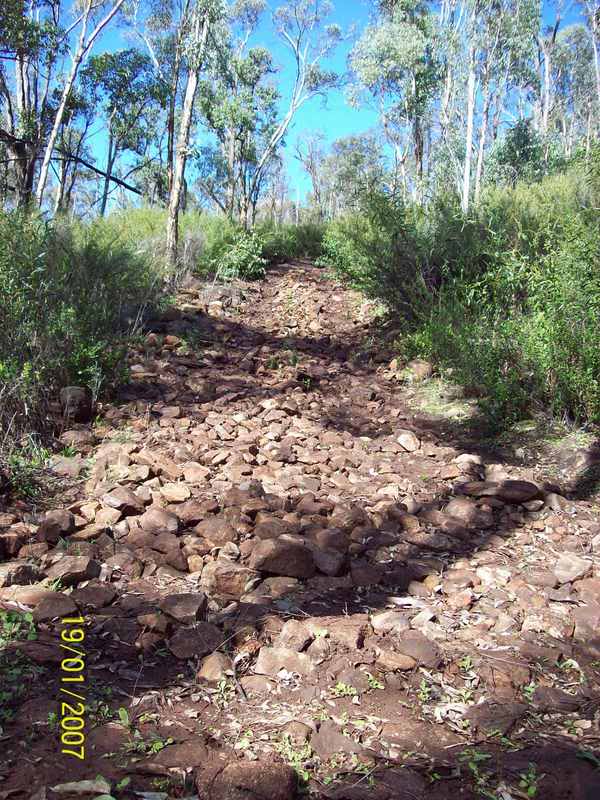

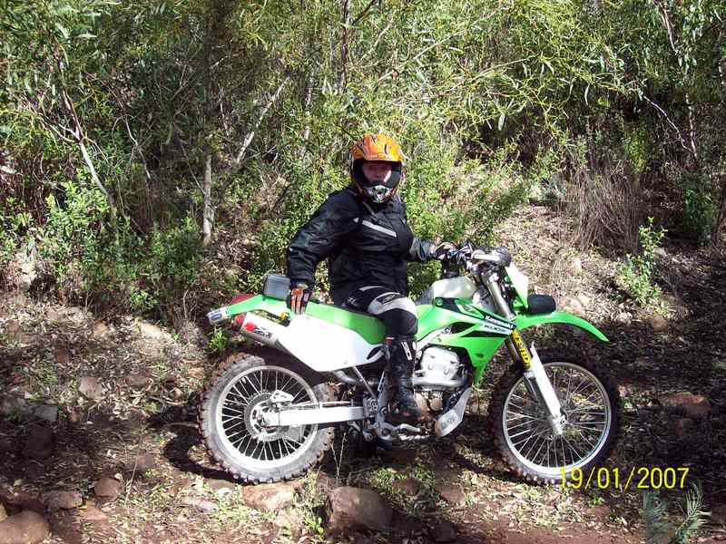

Here is another good view of how low my bike is now.
(Ignore the dates, not my camera).
When I looked at in the shed, I thought it was going to be too low.
But it turned out to be fine.
What i gain on the swings, far out ways what I lose on the roundabouts.
And when you are about to tackle this, it's a big help
