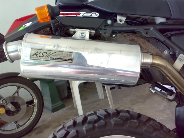

Oh yeah.. I have a Great Pipe too.. Its a brand called RSV..Heres a pic of it :
I'm at sea level.. And my jets are:
128 Main
35 Pilot (stock)
DJ Needle with the clip on the 3rd position.. Gonna change it to 2nd position to see what happens..
Should be alright yea?
