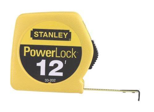

Interesting and clever product as is this...

As we used to say in the Navy: "What do you think you got? ...a calibrated eye?"
