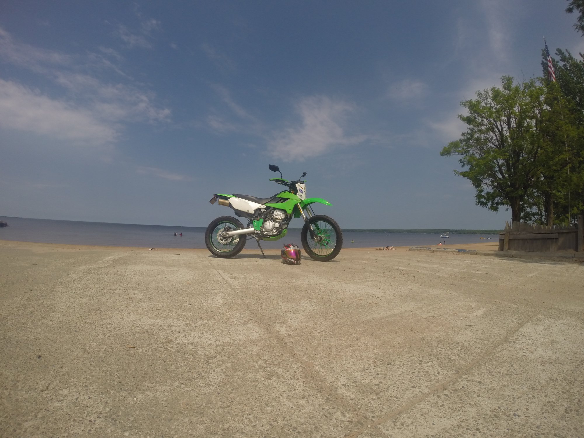

beach trip

The numberplate/headlight setup really turned out!

Im getting a lot of complements on the faceplate even from cops......cant wait til the white fork guards come in
