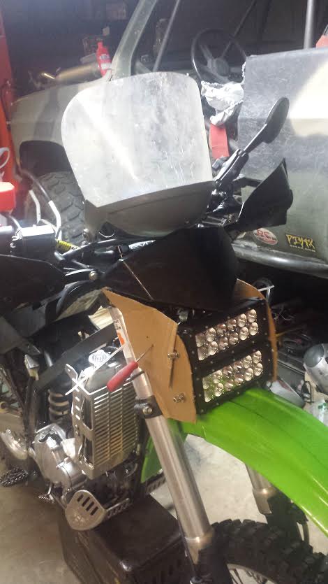

I am in the process of replacing my headlight with 2 8" led light bars. Here is a rough mockup. Need to start cutting my brackets.
I like the setup you have On your bike, if only my stock light was that bright for nighttime driving, very clever idea.
