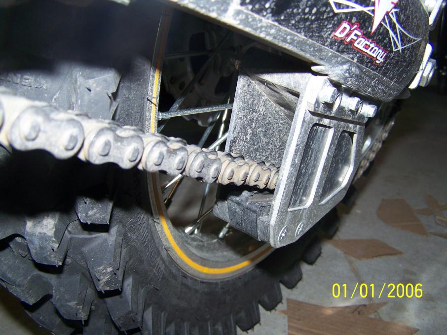

Old Nov 9, 2009 | 01:09 AM
TNC's Avatar
Posts: 5,050
From: Abilene, TX

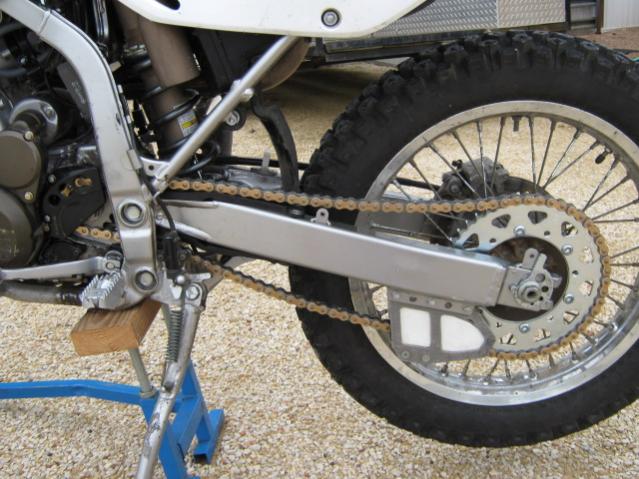

I'm thinking it's probably 47. I have 14/47 gearing on mine, and I have to remove the 3 bolts on the chainguide to get the rear wheel out with a new chain. As the chain wears a tiny bit, I can tell I'll have enough slack to slip it off, but not right now. I'm running a 100/100 Kenda Trak Master DOT knobby, so it's not a huge tire. Removing the chainguide is really easy, but mine has to come off to get the wheel out. If your tire is much bigger, you'll have to consider even more room. The 47 rear sprocket just doesn't let the wheel go forward quite far enough. Leaving another link in the chain would also alleviate this. There's no clearance, rubbing, or wear issue that I can see with the 47 otherwise to cause a problem. I just ran into this because my chain and setup has the axle at a very forward location to start with.

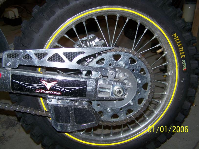

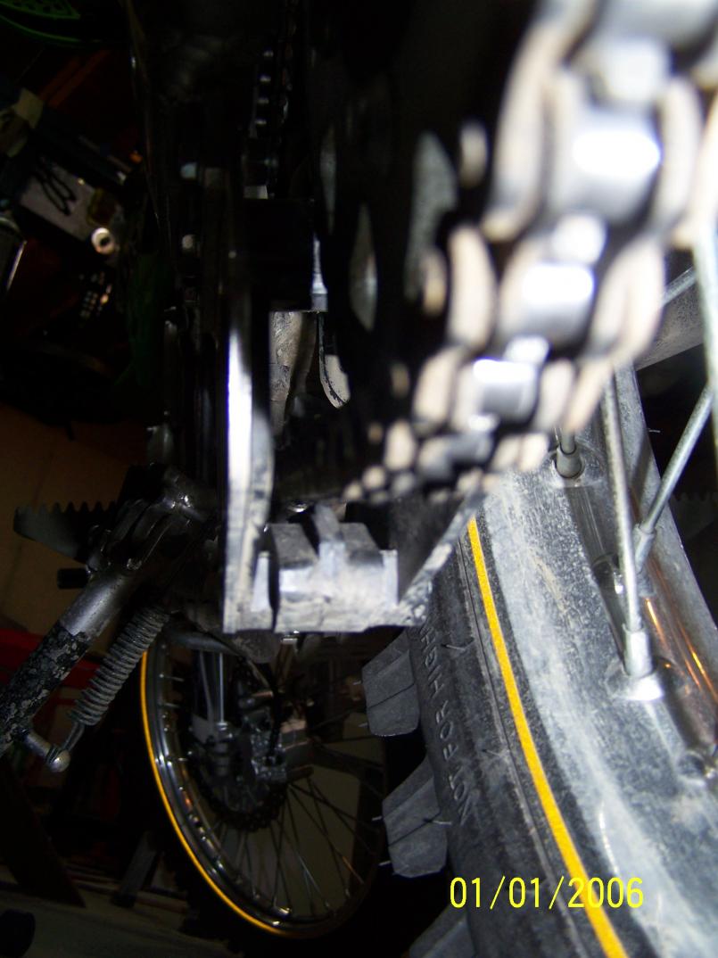

That does look like a tight fit with the 47T, what size are you running on the front? And how does the ratio feel? check out this clearance picture with the other guys 49T:

From memory it was either 48 or 49. 14/48 would be approx the same as 12/42. Of course one of those combos requires a new chain (you guess which one)

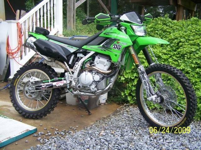

Default 52 sprocket
run a 52 sprocket no problems
Attached Thumbnails Largest reat sprocket w/o modifying chain guide?-100_0907.jpg
Old Nov 10, 2009 | 12:13 AM
skubidoobie's Avatar
Joined: Jul 2009
Posts: 198
From: Hell
That's a beauty, twotwins. Props in my book for style (and torque)! Ever ride on the highway with it?

Old Nov 10, 2009 | 12:50 AM
Did you mod the lower chain guard .... I ran a 49 tooth for a while, with the stock lower guard...I could not imagine going bigger with that stock guard.
Did it just rub a little and wear off some plastic?
Details on that.

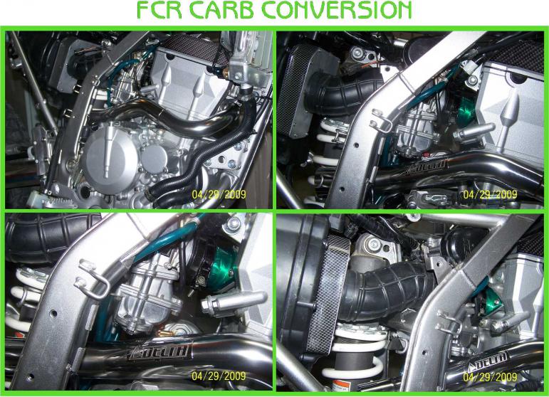

Default no highway
ride mostly dirt and back roads big bore kit with fcr carb
