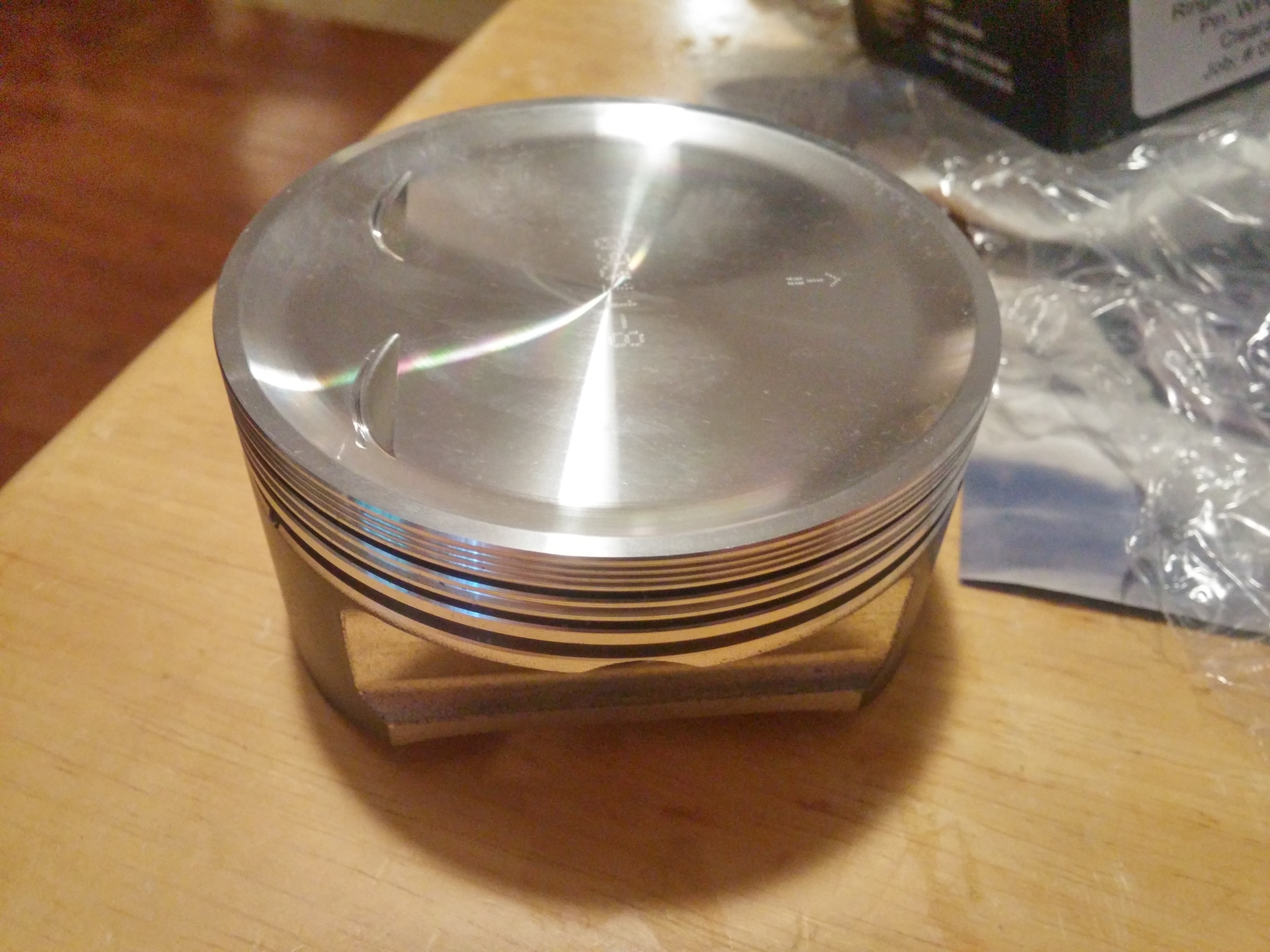

Now that I look at it, my new Wossner piston was slightly dished whereas my stock piston was mostly flat. I would guess that it was done to slightly lower the CR, I bet it is close to stock or slightly higher, havnt done the math.
I am still curious why you got a JE piston instead of a Wossner.... Was your piston dished slightly? I also only had 2 valve reliefs for the exhaust only.

I am not sure why a JE also ,but I am very familiar with them so i was cool with it.
I believe if I remember correctly the JE is dished 1.88mm with 4 valve reliefs.
I was doing some guesstimate math and figured the 11mm overbore increases the compression almost two points. 1.88 of piston dish dropped it to around mid 12's. Now I didn't factor in the reliefs as none of this is exactly accurate but it was looking like 12:1.

Can you look at this pic and tell me if the dish looks similar to yours? Wish I had measured it but too late now, I would guess it is around 1-2mm but let me know what you think

Yes. Looks very similar. Did you get a spec sheet with the piston?

I'll check again but I dont think so, just the box that said Wossner / USA KLX300R, Rings 830XDS-3, Diameter 82.94mm, Pin: WP090, Clip: CW17, Clearance: .06mm
