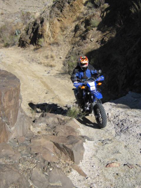

On using an SF, you'll be fine with the right tires. I'm not up on those particular Shinkos, but they look like Kenda 270's. I rode off road for a week with a guy in the Big Bend area of Texas who had a Yamaha WRX250 with the 270's. There was nothing he couldn't ride with those tires. They stuck quite well. They looked pretty neat on those 17" wheels.
Attached Thumbnails KLX250SF dirt ability, headed out for the Trans American Trail!-img_0114.jpg
