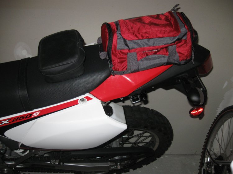

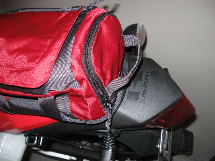

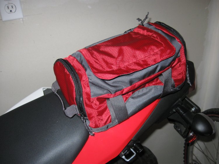

I recently replaced the storage tote on the back of my KLX250 with one that is about four times the size with a quick DIY project that cost me less than $20. Here's how.
1. Buy an Eddie Bauer Mini Duffel ($24 regular price, I got it on sale for $14).

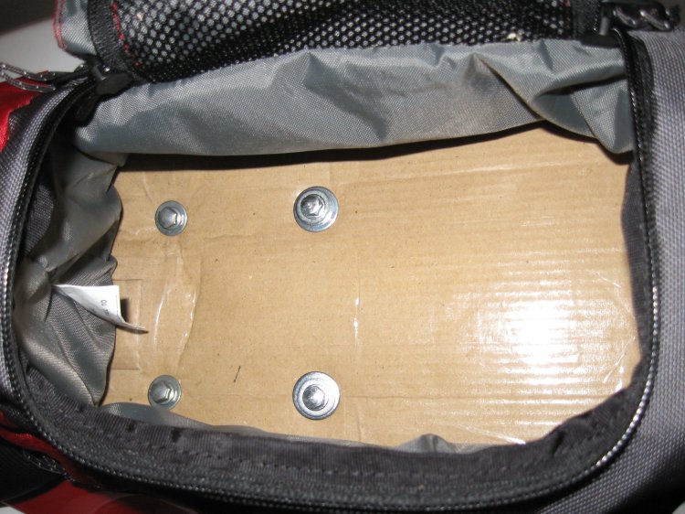

2. Cut some cardboard or other stiff material to fit in the bottom of the mini duffel.
3. Drill holes in the cardboard and the bag that match the pattern of the fasteners in the stock tote.
4. Use the stock fasteners to attach the mini duffel.
5. Add a small piece of velcro to secure the rear of the duffel to the bike.
Now instead of just being able to fit just the toolkit in the tote, I can fit a change of clothes or my lunch. The mini duffel is also water resistant! The mini duffel measures 5.5" H X 11.25" W X 5.5" D. It fits perfectly on the back of the bike and looks great!
Certainly less expensive than most other options.
I have attached some pictures so you can see my work. It only took me about an hour to complete.

I found using a cut up tupperware lid to be a good backing material. I think its PET plastic? Its strong and won't shatter so no bolt head will easily rip through it in an accident.
I did something similar but in a different place on my motard. I got a 6x9x3" kids canvas bag and bolted it up under the rear fender. It holds a spare innertube and some tools. Since the motard version runs shorter tires there's no way I can bottom my tire out on the bag.
I also moved my coolant to a baby bottle in front of a radiator so I freed up room for another small bag where the coolant tank was and that holds my other spare innertube. With a bicycle pump strapped to the frame, and tire irons in the airbox, I can never be stranded from a flat now.
