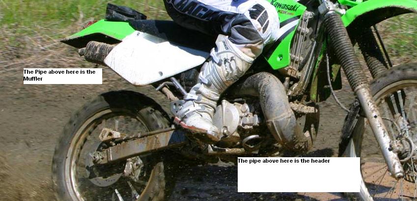

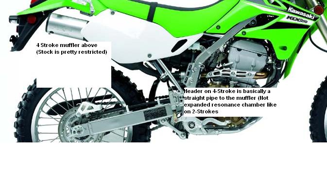

Let's be sure we are clear about this.
The attached pictures below identify KDX 2-Stroke Exhaust and KLX 4-Stroke Exhaust.
Notice the header on 2-Stroke is HUGE compared to the 4-strokes small pipe.
Ed179 ARE YOU SURE YOU HAVE A 2-STOKE HEADER ON THE KLX???
This is VERY unusual. If in fact you are somehow running a 2-stroke pipe on your KLX you are probably going to get some weird performance values off that puppy and certainly would not sound like a correct Thumper should.
Your best bet is to go back to the stock exhaust until you upgrade to a correct after-market 4-stroke system (Like Muzzy, FMF or 2-Bros).

To clarify: The header is stock KLX250s...it is just the can that is from the KDX.

Now that makes a lot more sense.
Not even sure the 2-stroke header would fit on the KLX.
