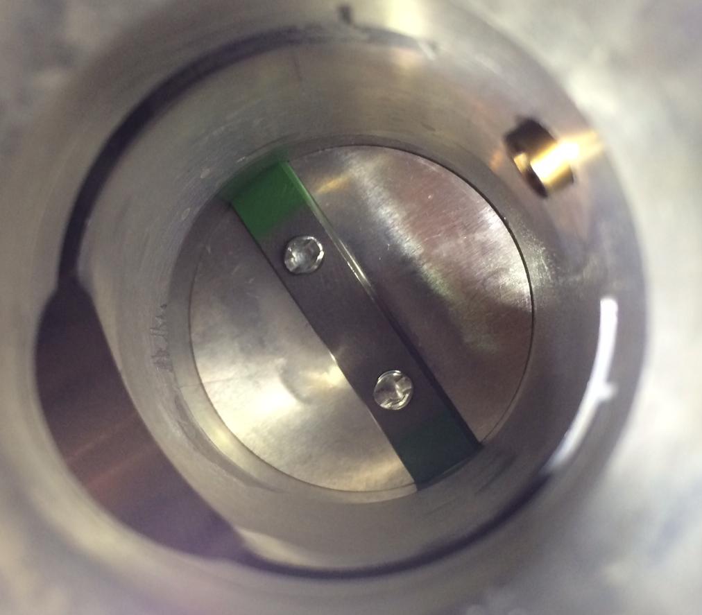

Went to replace my seals today, hoping that having the proper screw driver would alleviate the troubles you had removing the screws...
Nope. Check out what's on the back side of these guys:
The screws are punched on the backside so as to prevent them coming lose (or being able to remove / service the throttle plate!)

The exact specs for the screw that I removed (the in-tact one), was M4x0.7 5mm (probably 6, but I filed out the punch).
You might want to add that to the initial post if you can.
Now I have to tackle the damn near impossible task of sourcing a replacement here in Canada....
Also, how did you pull the butterfly shaft out neonarc? is there a retainer on one end or anything? Mine isn't budging.

There is a cap on one end and there is a C clip under it. The cap just pries off with a flat head screw driver.
