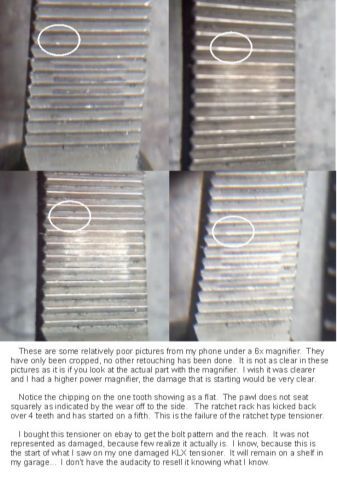

I also find it hard to believe there would be enough wear in that low of mileage to develop piston slap. It isn't a common thing like it can be on a two stroke. My bike has 15,000 on it and had a bad tensioner. Looked pretty much like the following picture. Unless you use a strong magnifier on the tensioner you won't see what the damage actually is...
The wear pattern here and that one polished tooth is the problem. The tensioner is junk.
When the engine decelerates the momentum of the cams pulls the cam chain tight on the back side, pushing back on the plunger. Normally the pawl would engage the tooth enough to hold it, but the top of the tooth has chipped and rounded as probably has the pawl. Now the pressure pops the pawl up and the plunger pushes in five teeth. The pattern is where the rack pushes back out Part looks good, but it isn't. The back side of the plunger will actually be polished due to the metal on metal sliding. None of that should should be there. It should click forward and hold, but it isn't doing it. A stronger spring is not the answer, the goal is to have as little actual tension on the chain as possible with as little chain slack as possible.
