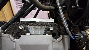

First off, ever since I did the upgrade the bike has not run right. Here are the pictures of the inside of the engine when I first pulled the cover. Note: I bought the bike new (0 miles) and no one had touched the engine as far as I know.
Now, the manual and the original thread about valve clearances shows a different configuration for how the cams are set. Has my bike been wrong from the factory?

Page 5-20 of the factory manual shows that at the "T" mark, the lobes should be out, looks like my cams are off 180 degrees. Seriously?
Would this affect valve clearances? I also had 2 valves replaced by the shop last summer when I was trying to get the bike running, they reassembled the bike just like my pictures, which is not what the manual shows. They said 2 of the valves were bad, I only have 5K on the engine, almost all of that is on the original head. I haven't gotten 15 miles on the new head because it won't stay running for more than 5 minutes.

You are off 180 degrees, rotate the crank one full turn to the T mark to get to TDC compression stroke. It is not a big deal, you are on TDC exhaust stroke. The cams will look just like this, with the lobes will be sticking out at about an 11 o'clock (approximate direction) on the intake and about 1 o'clock (approximate direction) on the exhaust. Notice the notches in each cam are 180 degrees opposite the ones in your picture. After rotating the crank one full rotation to T again, check your valves there and get whatever shims necessary to get clearance at that point.
Here is a link to the posts where this image came from. https://www.kawasakiforums.com/forum...problem-33685/
Key thing, the KLX and some other singles fire every 360 degree rotation of the crank, the spark on the exhaust stroke is what is called a wasted spark since it does nothing. It simply means as long as the piston is at TDC the cams installed properly will have it at TDC compression.
