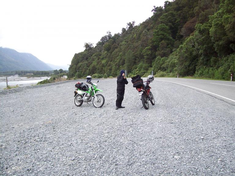

i want to see a pic of a kawasaki KIWI
Old Jul 9, 2013 | 11:22 PM
Karitane Pete's Avatar
Joined: Apr 2009
Posts: 183
From: Karitane, New Zealand
Originally Posted by zippets
I want to see a pic of a Kawasaki KIWI
Like this
or this
or the taller version
