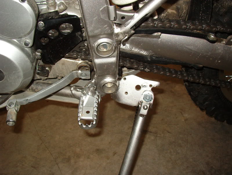

I removed my entire sidestand switch. Just like Cliffstaand TC said, there are too many stories about the switch breaking on the trail.
I took off the switch and followed the wires up to the main harness (under the seat on right side) cut the wires and spliced them together.
One less thing to break
