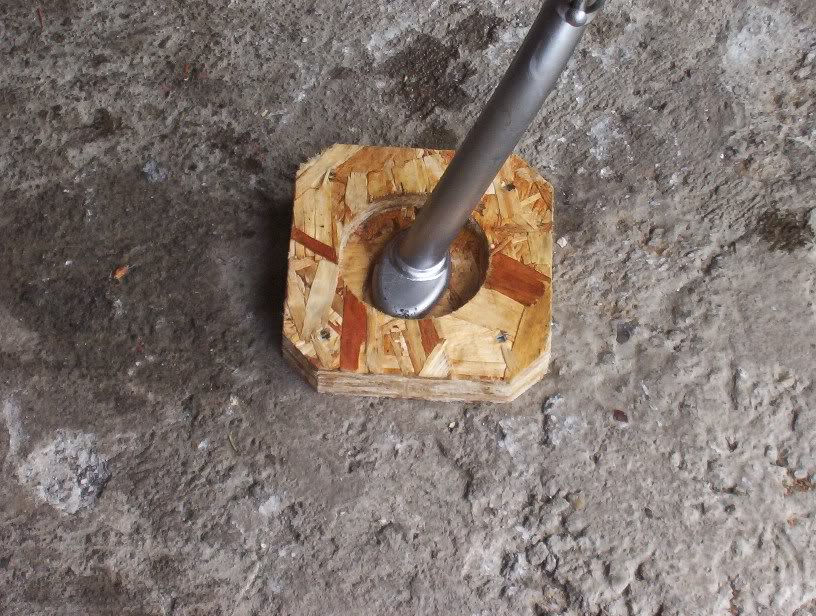

Actually mine is too short.....the kickstand I mean. I have the Dunlop 606 on it, and sometimes it feels like the bike is going to tip over because of the lean. In the garage I keep the kick stand on this...

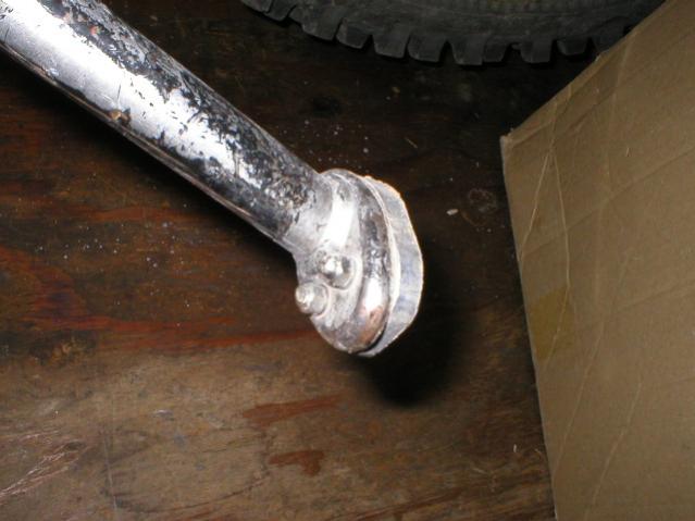

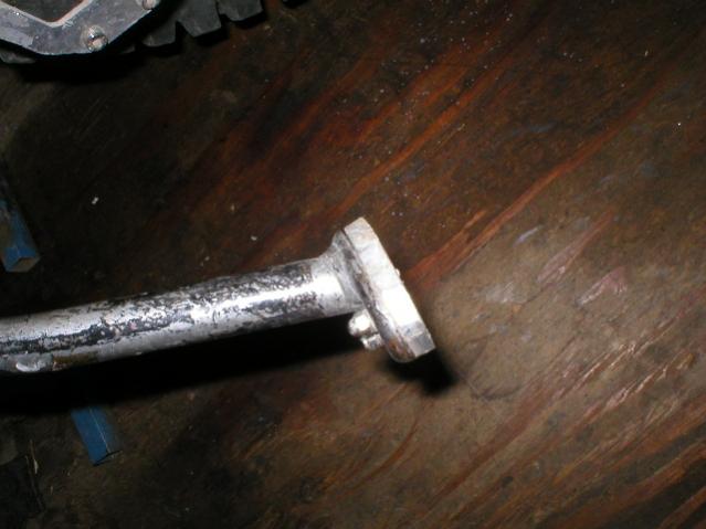

After doing the fork and shock springs with more suitable units for me, my bike "stood up" more than it had, so I had to mod my kickstand a little bit. The large foot pad on the OEM stand allows for the fitment of a "block" of whatever size you need to suit your needs. I cut off a piece of aluminum plate and sized it on a grinder to fit the foot pad. I drilled 2 holes in the foot pad and aluminum block and bolted it in place. The nice thing is that if anything else changes on my bike to alter the lean angle, I haven't ruined the OEM kickstand by cutting or welding. I can just make another aluminum block of the needed depth to replace the first one and just bolt it in place.
