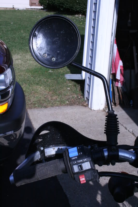

One of the casualties of my ride in the Leaf River DS ride last week was the glass in my Ken Sean folding mirror.

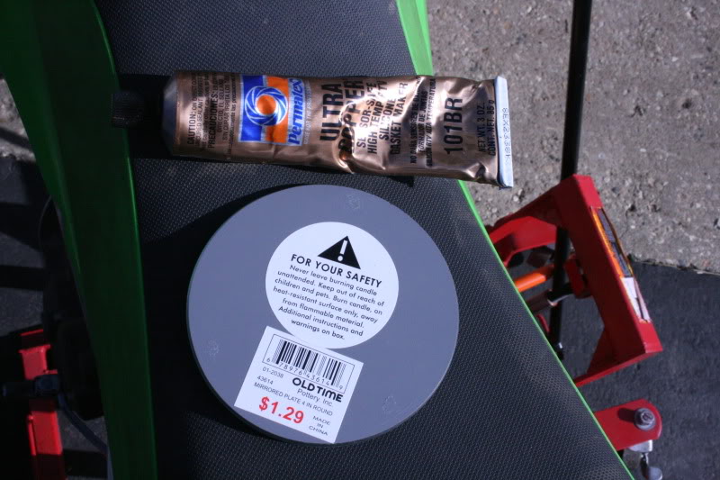

I had it folded down over the gauge cluster, but I dumped the bike and the mirror took a branch to the glass. Today I measured the opening and it was exactly 4". I had an idea that I could find a pre-cut round mirror at a craft store. Finally at the 3rd store I found a 4" mirror. Not exactly what I wanted because it has beveled edges, but for $1.29 I'll live with it.
Took it home and put it in the opening. Perfect fit, I almost couldn't get it out in order to "glue" it in. Put a few dabs of silicone around the inside of the housing and pressed the mirror in.

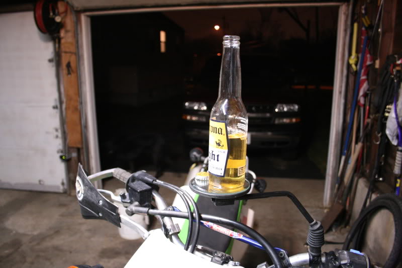

Old Nov 24, 2009 | 01:39 AM
LOL
Now that you mention it tucaz.
